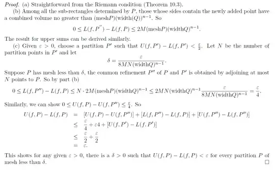

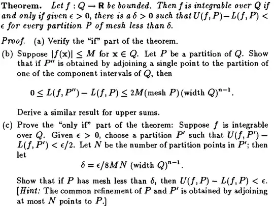

What shown below is a reference from "Analysis on manifolds" by James R. Munkres
To follow a proof of the theorem I have found here.
So I don't understand why $L(f,P'')-L(f,P)\le2M(\text{mesh} P)(\text{width}Q)^{n-1}$

  • If it is $$m_{R'{S,T,k}},v(R'{S,T,k})+m_{R''{S,T,k}},v(R''{S,T,k})\leqslant m_{R_{S,T,k}},v(R_{S,T,k})+2M ,\delta , v(S), v(T)$$ for any $R'{S,T,k},,R'{S,T,k}$ and $R_{S,T,k}$ then we sum over the subrectanlge these subrectangles and then we add to both sides the sum over the other common subrectangles of $P$ and $P''$ so that we have $$L(f,P'') \leqslant L(f,P) + 2M \delta \sum_{S,T}v(S), v(T)$$ is this right? – Antonio Maria Di Mauro Jun 26 '20 at 09:06
  • But if it seems I understood the first inequality (is what I say above correct?) unfortunately I can't understood the inequality $$L(f,P) + 2M \delta \sum_{S,T}v(S), v(T) \leqslant L(f,P) + 2M \delta, \lambda^{n-1}$$ that is $$2M \delta \sum_{S,T}v(S), v(T) \leqslant + 2M \delta, \lambda^{n-1}$$ so could you expalin this better, please? – Antonio Maria Di Mauro Jun 26 '20 at 09:06
  • Perhaps I understood. If $Q=[a_1,b_1]\times...[a_i,b_i]\times...\times[a_n,b_n]$ then the retangles of the form $S\times T$ determine a partition of $Q'=[a_1,b_1]\times...\times[a_{i-1},b_{i-1}]\times[a_{i+1},b_{i+1}]\times....\times[a_n,b_n]$ so that $\sum_{R,T}v(S)v(T)=v(Q')\le\lambda^{n-1}$, is this correct? – Antonio Maria Di Mauro Jun 26 '20 at 09:15
  • @AntonioMariaDiMauro: Yes. From your last comment it appears that you are understanding it correctly. – RRL Jun 26 '20 at 14:07
  • Okay, thanks too much for your assistance! – Antonio Maria Di Mauro Jun 26 '20 at 22:21
