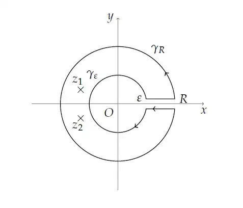

We chose the multiple-valued function $f(z)$ with branch cut $\arg z=0$ defined as
$$ \begin{align*} f(z) &=\frac{\log ^{2}z}{\left( z+a\right) ^{2}+b^{2}},\quad \text{with } 0<\arg z<2\pi ,\quad z=re^{i\theta } \\ &=\frac{\log ^{2}z}{\left( z-z_{1}\right) \left( z-z_{2}\right) }\qquad z_{1}=-a+ib,\quad z_{2}=-a-ib, \end{align*} $$
and integrate it counterclockwise around the closed contour $\Gamma $ shown in the figure. This contour is indented around the branch point $O$ and consists of the circles $\gamma _{R}$ ($\left\vert z\right\vert =R$) and $\gamma _{\varepsilon }$ ($\left\vert z\right\vert =\varepsilon $), $ 0<\varepsilon <1<R$, and the segment $\left[ \varepsilon ,R\right] $ described in the positive sense above the $x$-axis and in the negative sense below the $x$-axis.
$\qquad\qquad$enter image description here
$$\text{Closed contour } \Gamma $$

$$ \begin{align*} I &=\lim_{\varepsilon \rightarrow 0,R\rightarrow \infty }\oint_{\Gamma} \frac{\left( \log z\right) ^{2}}{\left( z+a\right) ^{2}+b^{2}}\,dz, \\ &=\int_{0}^{\infty }\frac{\left( \log r\right) ^{2}}{\left( r+a\right) ^{2}+b^{2}}\,dr-\int_{0}^{\infty }\frac{\left( \log \left( re^{i2\pi }\right) \right) ^{2}}{\left( re^{i2\pi }+a\right) ^{2}+b^{2}}\,dr \\ &\quad+\lim_{R\rightarrow \infty }\int_{\gamma _{R}}\frac{\left( \log z\right) ^{2}}{\left( z+a\right) ^{2}+b^{2}}\,dz-\lim_{\varepsilon \rightarrow 0}\int_{\gamma _{\varepsilon }}\frac{\left( \log z\right) ^{2}}{\left( z+a\right) ^{2}+b^{2}}\,dz \\ &=\int_{0}^{\infty }\frac{\left( \log r\right) ^{2}-\left( \log r+i2\pi \right) ^{2}}{\left( r+a\right) ^{2}+b^{2}}\,dx \\ &=4\pi ^{2}\int_{0}^{\infty }\frac{1}{\left( r+a\right) ^{2}+b^{2}} \,dr-i4\pi \int_{0}^{\infty }\frac{\log r}{\left( r+a\right) ^{2}+b^{2}}\,dr \end{align*} $$
provided that
$$ \lim_{R\rightarrow \infty }\int_{\gamma _{R}}\frac{\left( \log z\right) ^{2} }{\left( z+a\right) ^{2}+b^{2}}\,dz=\lim_{\varepsilon \rightarrow 0}\int_{\gamma _{\varepsilon }}\frac{\left( \log z\right) ^{2}}{\left( z+a\right) ^{2}+b^{2}}\,dz=0,\quad \text{(see below).} $$
By the residue theorem,
$$ \begin{align*} I &=2\pi i\left( \operatorname{Res}_{z=z_{1}}f(z)+ \operatorname{Res}_{z=z_{2}}f(z)\right) \\ &=2\pi i\left[ \operatorname{Res}_{z=z_{1}}\frac{ \left( \log z\right) ^{2}}{\left( z-z_{1}\right) \left( z-z_{2}\right) }+ \operatorname{Res}_{z=z_{2}}\frac{\left( \log z\right) ^{2}}{\left( z-z_{1}\right) \left( z-z_{2}\right) }\right] \\ &=2\pi i\left[ \frac{\left( \log z_{1}\right) ^{2}}{z_{1}-z_{2}}+\frac{ \left( \log z_{2}\right) ^{2}}{z_{2}-z_{1}}\right] \\ &=2\pi i\left[ \frac{\left( \log \left( -a+ib\right) \right) ^{2}}{i2b}- \frac{\left( \log \left( -a-ib\right) \right) ^{2}}{i2b}\right] \\ &=\frac{\pi }{b}\left[ \log \left( -a+ib\right) \right] ^{2}-\frac{\pi }{b} \left[ \log \left( -a-ib\right) \right] ^{2} \end{align*} $$
We now assume that $a,b>0$. Then
$$ \begin{align*} I &=\frac{\pi }{b}\left[ \log \left( \left\vert -a+ib\right\vert \right) +i\left( \pi -\arctan \left( \frac{b}{a}\right) \right) \right] ^{2} \\ &\quad-\frac{\pi }{b}\left[ \log \left( \left\vert -a-ib\right\vert \right) +i\left( \pi +\arctan \left( \frac{b}{a}\right) \right) \right] ^{2} \\ &=\frac{\pi }{b}\left[ \frac{1}{2}\log \left( a^{2}+b^{2}\right) +i\left( \pi -\arctan \left( \frac{b}{a}\right) \right) \right] ^{2} \\ &\quad-\frac{\pi }{b}\left[ \frac{1}{2}\log \left( a^{2}+b^{2}\right) +i\left( \pi +\arctan \left( \frac{b}{a}\right) \right) \right] ^{2} \\ &=\frac{4\pi ^{2}}{b}\arctan \left( \frac{b}{a}\right) -i\frac{2\pi }{b} \arctan \left( \frac{b}{a}\right) \log \left( a^{2}+b^{2}\right) \end{align*} $$
because $$ \log \left( \left\vert -a+ib\right\vert \right) =\log \left( \left\vert -a-ib\right\vert \right) =\frac{1}{2}\log \left( a^{2}+b^{2}\right) . $$
Taking the imaginary part of $I$ we obtain $(\ast)$ in the form $$ \text{Im }( I )=-4\pi \int_{0}^{\infty }\frac{\log r}{\left( r+a\right) ^{2}+b^{2} }\,dr=-\frac{2\pi }{b}\arctan \left( \frac{b}{a}\right) \log \left( a^{2}+b^{2}\right) $$
