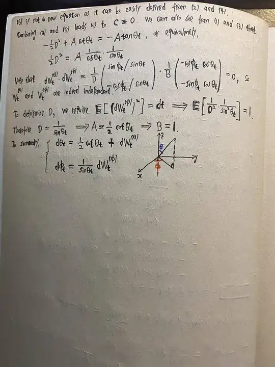

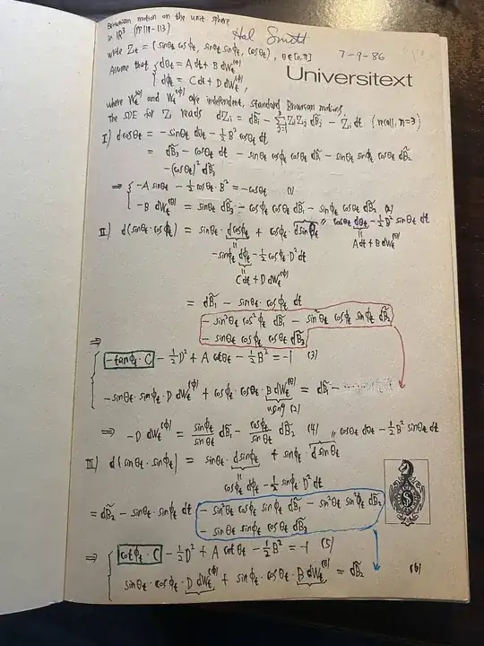

As an alternative approach for the derivation of the advertised conclusion (in my opinion, this is a more elementary approach). You can take a look at Example 8.5.8 in Oksendal's classical textbook on SDEs, in which the author used a random time change argument to drive the SDE satisfied by a Brownian motion on the unit sphere in $\mathbb{R}^n$ (with $n \geq 3$). This SDE is written in the cartesian coordinates. However, when we consider the special case $n = 3$, a simple Ito-type computations enable us to transform the SDE in cartesian coordinate to the SDE in spherical coordinate $(\theta,\phi)$. I attached the detailed computations below, I hope you can follow and understand.

  • why the downvote? I feel this is a detailed answer – Fei Cao Jul 27 '21 at 05:41
  • Very helpful answer. Can you elaborate more on the relation of the details you provided with the proof of example 8.5.8 of Oksendal? There he starts with applying a function to BM. Also there is important time change in the proof. I cannot however see information in this regard in your answer. Can you please extend and update your answer? – Kevin Dec 01 '23 at 15:51
