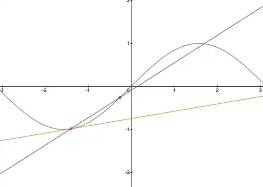

In the pre-calc definitions you give, the term $m_{\text{sec}}$ is called this way because it represents the slope of a line which intersects the curve given by the function $y=f(x)$ in 2 points: $(x,f(x))$ and $(a,f(a))$.
Similarly, the term $m_{\text{tan}}$ is called this way because it represents the slope of a line which only touches the curve at the point $(x,f(x))$.
In the diagram below you can visually see this. Here the red dot is the point $(x,f(x))$, the blue point is $(a,f(a))$, $m_{\text{sec}}$ would correspond to the slope of the purple line, and $m_{\text{tan}}$ corresponds to the slope of the orange line.
Diagram of secant and tangent lines
As far as the relation of these definitions of tangent and secant with how they're used in trigonometry, pyon's answer gives the diagram of the visual representation of secant and tangent functions as lines. Here we see that the secant function can be seen as a line that intersects the unit circle in 2 points, and similarly, the tangent function can be seen as another line which only touches the unit circle once.

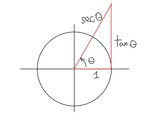

The names of the trigonometric functions “tangent” and “secant” come from the following red triangle:
The circle above is the unit circle. The line that has length $\tan \theta$ is tangent to the circle, whereas the line that has length $\sec \theta$ is secant to the circle.
As far as I can tell, there is no relation whatsoever between, on the one hand, the functions $\tan$ and $\sec$, and on the other hand, tangent and secant lines to arbitrary curves.
