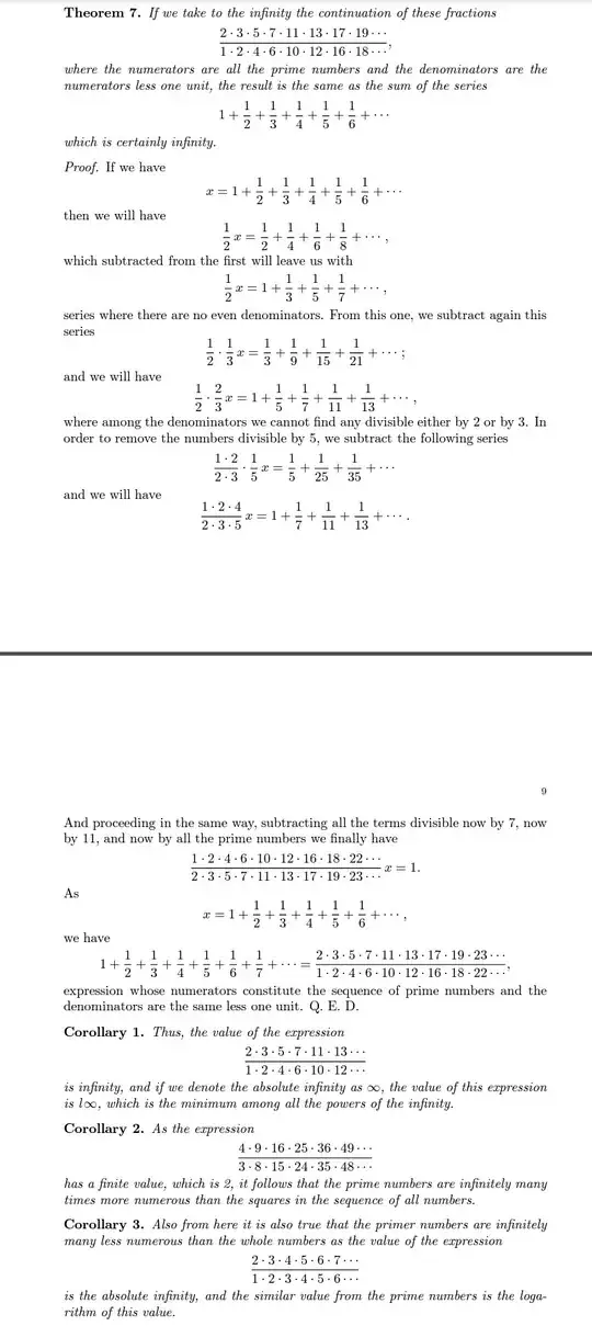

Will someone please help me in understanding the claims of corollary $2$ and $3$?
I understand that corollary $2$ means for large $N$ there are more primes than squares in the interval $[1,N]$ which can also be seen alternatively using Prime Number Theorem. But I want to understand it from the Claim made in this corollary by Euler.
I know the proof given here is wrong and lacks rigor. Actually this proof was given by Euler. Can we anyway reach to corollary by bypassing the wrong proof ?
Any help would be appreciated. Thanks in advance. enter image description here

    No..it is not in terms of bijection, it is rather in terms of density. I am aware of that proof using prime number theorem. I was just curious whether we could also prove that using the corollary. – math is fun Jun 15 '20 at 21:46

    Between $1..N$ there are $\pi(N)$ primes and $\sqrt{N}$ squares and $\pi(N)>\sqrt{N}$, quite a few details are provided here. – rtybase Jun 15 '20 at 22:01
