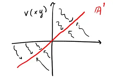

Here is an example which I used recently (for another related purpose in an assignment). Let $k$ be a field. Consider the ring homomorphism $k\lbrack t\rbrack\to k\lbrack x,y\rbrack /(xy)$ with $t\mapsto x+y$ (or alternatively, the inclusion $k\lbrack x + y\rbrack\subset k\lbrack x,y\rbrack /(xy)$). This map is integral because $x^2 - x(x+y)=0$ in $k\lbrack x,y\rbrack /(xy)$ and symmetrically for $y$. But in $k\lbrack t\rbrack$, the maximal ideal $(t+1)$ has both $(x,y+1)$ and $(x+1,y)$ lying over it. In case you know some algebraic geometry, here is a visualization of the map at the level of varieties:
The ring $k\lbrack x,y\rbrack /(xy)$ corresponds to the union of the coordinate axes, whereas $k\lbrack t\rbrack$ is the red affine line in the drawing. The squiggly arrows indicates the map of varieties corresponding to the map of algebras I gave. Note how every point (maximal ideal) along the red line has two points (maximal ideals) lying over it -- except for the point at the origin.
