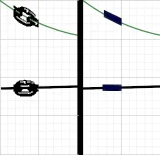

When I want to visualize or conceptualize the real line object of Synthetic Differential Geometry, I usually think of an infinitely long chain built from tiny metallic links. You may think of these tiny links as the nilsquare infinitesimal neighborhoods of ordinary numbers.
Applying a function to the real line
Applying a function allows us to twist and turn the chain into seemingly arbitrarily complicated curves.
However, when we focus on a single link, we see that the transformation behaved linearly: its overall shape of the link remains the same, even though the orientation changed. The Kock-Lawvere axiom allows us to inspect these orientations.
Kock-Lawvere axioms allow us to inspect linear orientation
This visual metaphor is far from perfect: the real line object behaves how it behaves, its behaviors need not correspond exactly† to the behavior of any physical object we interact with. Fortunately, the metaphor does account for several intuitive properties of the real line object:
  • We can define smooth curves, but not jagged ones: to create the function $x \mapsto |x|$, we must "remove a link" around $0$.
  • Zooming in on a chain, we don't find that the links consist of smaller chains. These small links are quantitatively different objects from the whole line. This explains what went wrong with your first intuitive picture (microscopic clone of the full line).
  • Interpreting the preorder relation $x \leq y$ as "the link containing the point $x$ lies to the left of the link containing the point $y$, unless they lie on the same link" motivates the observation that $0 \leq \varepsilon$ and $\varepsilon \leq 0$ both hold for any $\varepsilon \in D$. (Keep in mind that this is not the only type of preorder $\leq$ used in the literature.)
