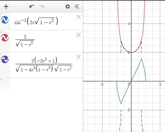

[Plotted is Desmos1

My guess: May be this is because replacing $x$ with $\sin \theta$ changes the range of $x$ from $(-\infty,\infty )$ to $[-1,1]$ and may be it causes some issue.

    Because each of $\sqrt{1-\sin^2\theta}=\cos\theta$ and $\sin^{-1}(\sin 2\theta)=2\theta$ does not necessarily hold. Take $\theta=\frac{5\pi}{8}$. – mathlove Jun 14 '20 at 05:35
Your guess is wrong. The range of x in original equation is [-1,1] to make the thing inside square root positive.
The problem starts when author writes sin^-1(sin(2theta)) = 2theta. This is wrong. Read about inverse trigonometry functions. The wrong thing is this is true for only some values of theta. For example, put theta = 60 degrees
  • the range of $x$ is $[-0.7071,0.7071]$ as the domain of $\sin\alpha$ is $[-1,1]$ so $2x\sqrt{1-x^}=[-1,1]$ – Soyeb Jim Jun 13 '20 at 06:42
    Let f(x) = 2xsqrt(1-x^2). Then x=+-1/sqrt(2) is the point of local maxima where the value of f(x) gets 1 before and after which its value decreases. – Aditya Kumar Jun 13 '20 at 11:43
