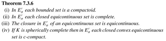

In the general non-Archimedean case, instead of using the concept of compactness, it is more suitable to use the concept of compactoidness. I think the theorem you are looking for is enter image description here
(page 273) all the details and preliminaries are in the spectacular book: Locally Convex Spaces over non-Arquimedean Valued Fields, Cambridge University Press - [C.Perez-Garcia, W.H.Schikhof] - 2010
