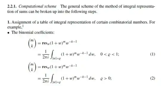

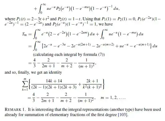

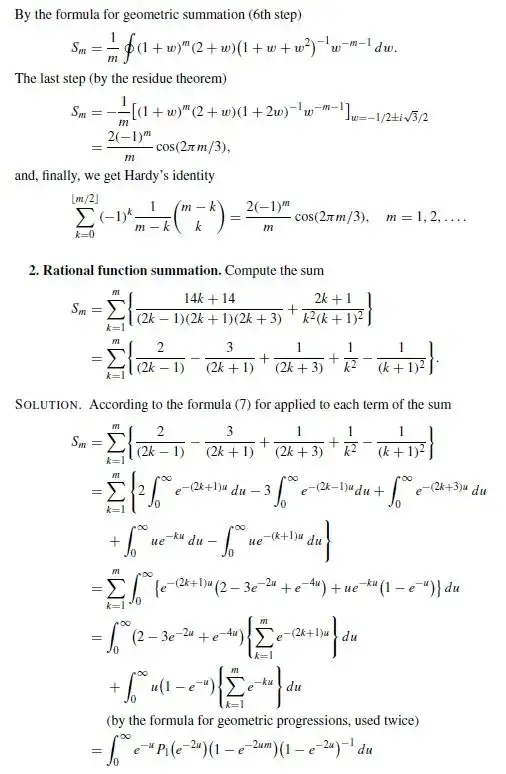

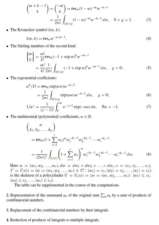

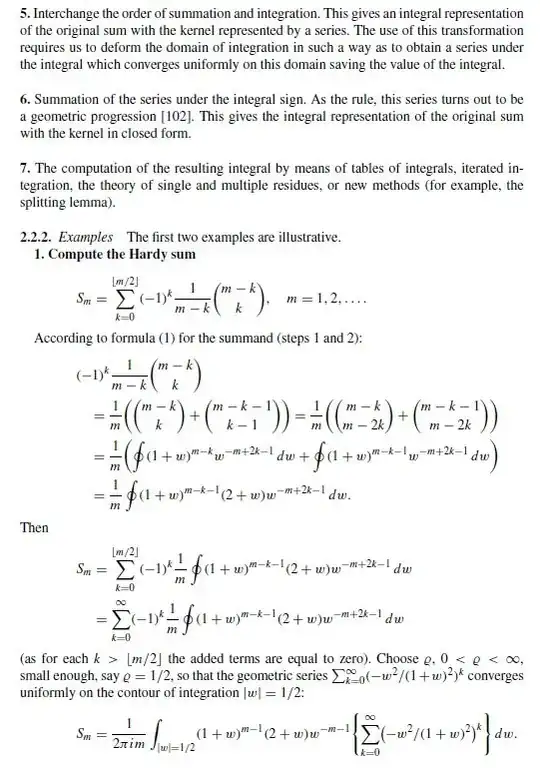

There is a very powerful calculus of multidimensional residues that accomplishes what you seek, see for example the book G. P. Egorychev. Integral representation and computation of combinatorial sums. AMS, Transl. of Math. Monogr. v. 59 Providence 2nd ed. 1989. Below are two illustrative examples of Egorychev's "method of coefficients" excerpted from the survey by Egorychev and Zima in volume 5 of Hazewinkel's Handbook of Algebra:
alt text alt text alt text alt text alt text
