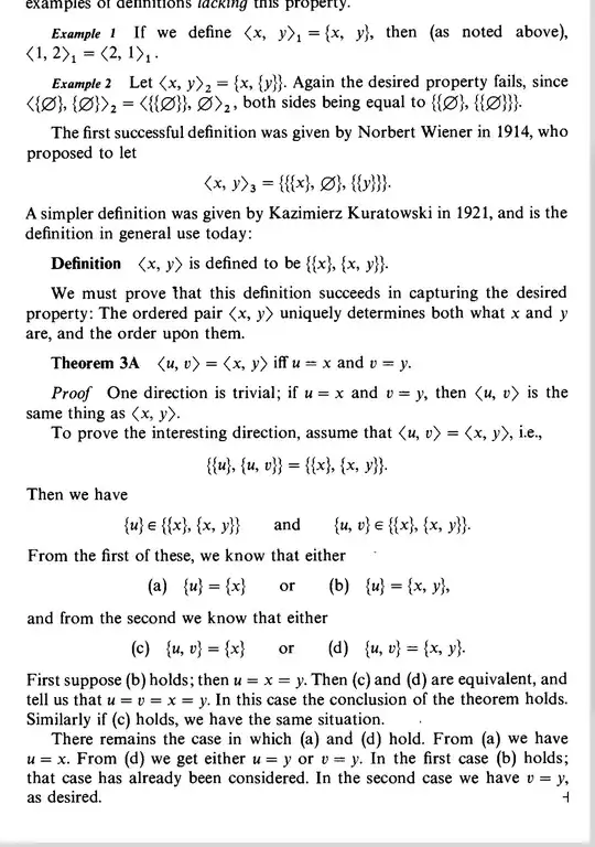

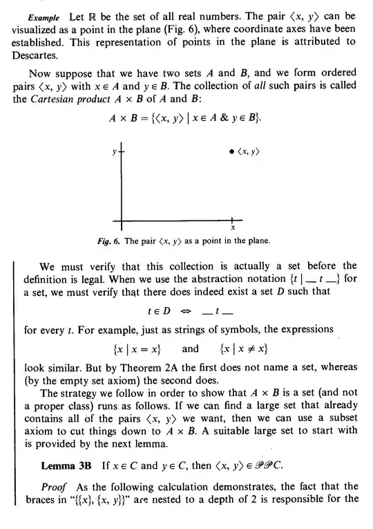

But it doesn’t seem enough. So, I checked Enderton’s book on Set Theory and he gave a detailed explanation, but I don’t get it. Here his explanation: Ordered pair Ordered pair 2
I still can’t see why the notation { {x}, {x, y}} represent an ordered pair (x,y) instead of a single element and a pair. I know this is basic stuff, but I would appreciate if you could help me understand it.

There is no one fixed way to define an ordered pair in terms of sets. It is also common to define an ordered pair as $(x,y) := \{x, \{x,y\}\}$. One can prove that $\{x_1, \{x_1,y_1\}\} = \{x_2, \{x_2,y_2\}\} \iff x_1 = x_2$ and $y_1 = y_2$.
The most important point is that it is indeed possible to define an ordered pair in terms of sets, so we are allowed to work with ordered pairs.
