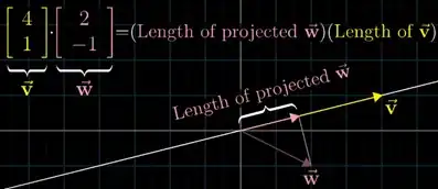

Dot product of $\vec{v}$ and $\vec{w}$ is multiplication of projection of $\vec{w}$ on $\vec{v}$ and length of $\vec{v}$.
Here, he gives explanation of how dot product is related to projections.

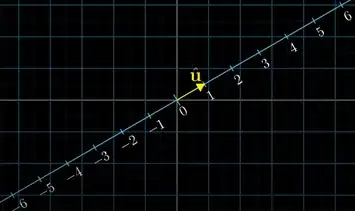

  2. Given two vectors $\vec{u}$ and $\vec{v}$, lets plot a number line passing through the $\vec{u}$. Lets assume $\vec{u}$ is a unit vector denoted by $\hat{u}$?

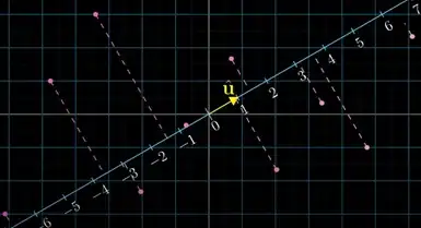

  3. Defining projection transformation Projection transformation on this number line can be defined as follows:
    Above each pink dot represent end point of a vector.
  4. So, this projection transformation defines projection of any vector $\vec{v}$ on $\hat{u}$
