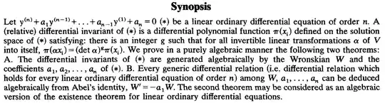

TL;DR: For the first two excerpts see
Kung, Joseph P. S.; Rota, Gian-Carlo On the differential invariants of a linear ordinary differential equation. Proc. Roy. Soc. Edinburgh Sect. A 89 (1981), no. 1-2, 111–123.
For the last excerpt see the exercises on page 57 of the 4th edition of the book Rota mentions.
The first excerpt refers to a theorem proved by Appell in 1881 (http://www.numdam.org/item/ASENS_1881_2_10__391_0/). According to the paper by Kung-Rota, the novelty of their paper is that they prove the theorem in a purely algebraic manner, whereas Appell uses analysis. I didn't look at Appell's paper, but I can verify that Kung-Rota uses no analysis. Their proof can be considered as a meditation on the universality of the determinant. Here is the abstract:
The second excerpt is related to a remark in the same paper on the elimination theory developed by the Ritt school. The analogy between classical invariant theory and linear differential equations seems to be about what is called "differential algebra", that is, algebra of $+,-,\times,\div,\;'$, the prime acting linearly and according to the product rule for derivatives.
