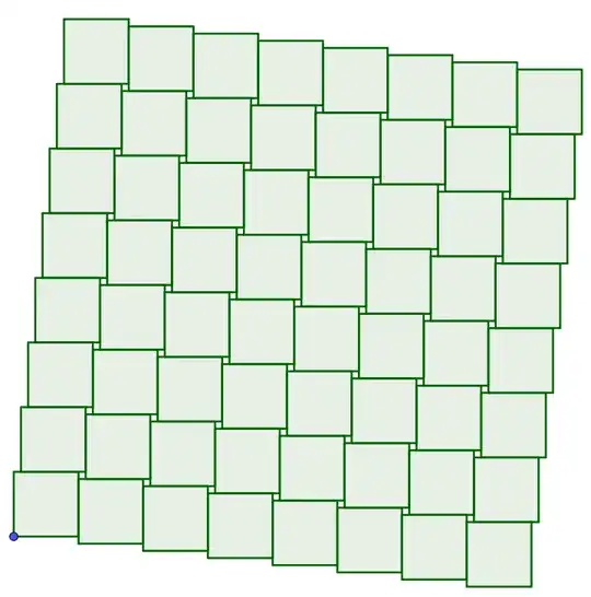

Proposition 5. For each natural $k\ge 4$, $s(k^2)\le k^2/4+k$.
Proof. Consider the following configuration of $k^2$ squares of size $a$ contained in a big square.
Let the catching grid consists of $h$ horizontal and $v$ vertical lines, so it catches at most $(h+1)(v+1)$ squares. Removing empty grid cells, we can assume that the distance between any two parallel grid lines it at most $a$ and $h,v\le k$. This provides all squares crossed by parallel grid lines are distinct. It is easy to check that each grid line crosses at least $k-1$ squares, so the grid crosses at least $h(k-1)+v(k-1)-hv$ squares ($hv$ is subtracted because of the double count), and so it catches at most $k^2-(k-1)(h+v)+hv$ squares. Put $h+v=2x\le 2k$. By the inequality between arithmetic and geometric means, $hv\le x^2$. So the grid cathes at most $\min\{x^2+2x+1, k^2-2(k-1)x+x^2\}$ squares. The following cases are possible:

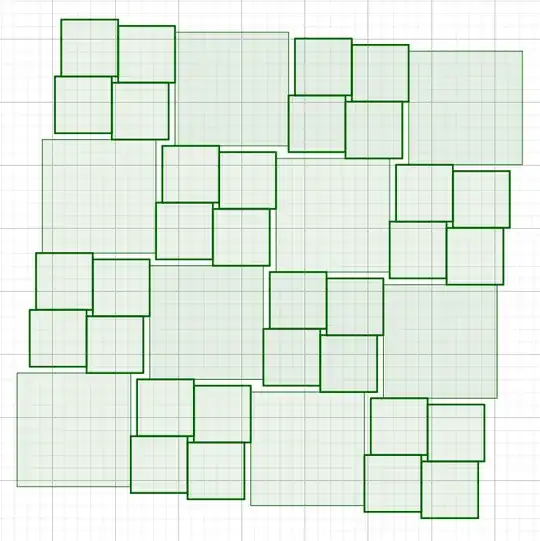

EDIT: In the pattern below there are 40 squares, and it seems that the maximum score is 8, which implies an asymptotic upper bound $s(n)\leq n/5$ (not sure how to verify this):

  • @AlexRavsky Suppose that, in the above pattern, we replace blocks of 2-by-2 unit squares, with a single 2-size square, so that in each block of 4-by-4, we have only 10 squares (two large squares and eight small squares). Then, when cutting every other row and every other column, only 2 small squares survive, which gives a ratio of $1/5$. Is it correct? – Erel Segal-Halevi Jan 19 '21 at 09:25
