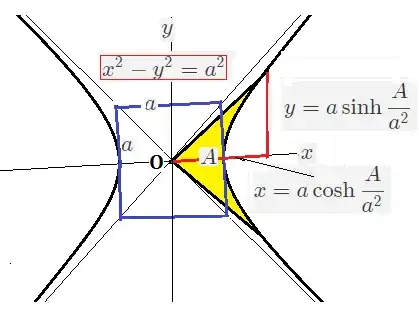

Geometrical meaning is shown in the rough hand sketch:
Hyperbolic angle magnitude is the non-dimensional yellow area of its hyperbolic sector marked $A$ divided by $a^2$. This is the argument of hyperbolic functions.
To get $x (y)$ co-ordinates we need to divide the area $A$ by square of axis $a,$ take its $\cosh (\sinh) $ and multiply by $a$.

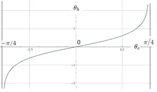

First of all it is noted the "hyperbolic angle" is related to central polar euclidean angle $θ_e$ that the radius vector makes angle to x-axis. The hyperbolic angle is not included between any two lines.
$$ \theta_h= A/a^2 = \frac12\; \log (\tan(π/4+θ_e)):$$
This area relation is found by direct integration.

  • In the meantime, thank you very much and I voted positively appreciating your answer. +1. Given the equilater hyperbola $x^2-y^2=a^2$, why do I write $y=a\sinh A/a^2$ (idem for the abscissa)? I have seen the $\sinh$ and $\cosh$ switch: https://upload.wikimedia.org/wikipedia/commons/thumb/f/f3/Hyperbolic_functions.svg/310px-Hyperbolic_functions.svg.png – Sebastiano May 24 '20 at 15:03
  • I can see no swap – Narasimham May 24 '20 at 15:39
  • Yes yes excuse me. Please why must be $x=a\cosh A/a^2$, $y=a\sinh A/a^2$? – Sebastiano May 24 '20 at 15:41
