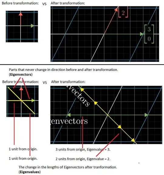

This video has a good simple explanation that also includes math. [2016, 3Blue1Brown, "Eigenvectors and eigenvalues | Essence of linear algebra, chapter 14"]
My very loose interpretation of the 'meaning' from that video is as follows:
Eigenvectors can be visualized as a line that's an axis of rotation, where no matter how much things change around it, the angle / direction of this line doesn't change.
I visualize it first like a fan, where regardless of how much the blades spin, its centerpoint ("Eigenvector") is still pointed in the same direction.
In a matrix that involves a transformation, it can also be thought of as a kind of rotation, but one where the rotation can change the lengths of vectors within a zone of rotation.
After a transformation, there can still be one or more such lengths that don't change in direction (Eigenvectors), but will change in size. The change in size would be the "Eigenvalue", like an Eigenvalue of 2 indicates that the length of the Eigenvector had doubled after transformation and 1/2 would mean it had reduced by half.
The picture below, based on that video link, would be an illustration of the above explanation.
Illustrated explanation of Eigenvectors and Eigenvalues
