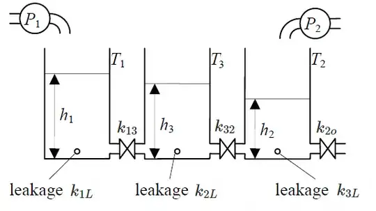

This question is very closely related to another question previously asked here on Math Stackexchange, where linearization of a three-tank-system is discussed.
After linearization you would get at multiple lines factors of the form $\frac{h_1 - h_3}{2|h_1 - h_3|^{\frac{3}{2}}}$, where $h_i$ denotes the water level in a certain tank $i$. A common control objective is to bring the water level of all three tanks to a certain height, but wouldn't this result in a singularity where the denominator is going to zero, and thus the entire fraction going to infinity?
My question is: Is this a problem when trying to control the water level in all three tanks, and if it is, is there a way around this?
