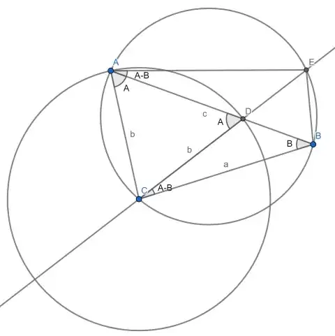

Assume that $a>b$.
There exists a point $D$ on line segment $AB$ such that $CD=b$, Produce $CD$ to meet the circumscribed circle of $\Delta ABC$ at point $E$. (See the figure below.)
Since $AC=CD$, $\angle CDA=\angle CAD=A$. Hence, $\angle BCD=A-B$.
Since $\angle BAE$ and $\angle BCE$ are angles in the same segment, $\angle BAE=\angle BCE=A-B$.
Applying the power theorem on the circle with center $C$ and radius $b$, we have $AB\cdot BD=a^2-b^2$. Since $AB=c$, $BD=\dfrac{a^2-b^2}{c}$.
Note that $\Delta BDE$ and $\Delta CDA$ are similar. We have $BE=BD=\dfrac{a^2-b^2}{c}$.
Applying the sine formula on $\Delta ABE$, we have $\dfrac{BE}{\sin\angle BAE}=2R$, where $R$ is the radius of the circumscribed circle of $\Delta ABC$. Hence, we have $\dfrac{c\sin(A-B)}{a^2-b^2}=\dfrac{1}{2R}$.
If $b>a$ instead, then we have $\dfrac{c\sin(B-A)}{b^2-a^2}=\dfrac{1}{2R}$. But $\dfrac{c\sin(A-B)}{a^2-b^2}$ and $\dfrac{c\sin(B-A)}{b^2-a^2}$ are indeed equal.
Similarly, we have $\dfrac{b\sin(C-A)}{c^2-a^2}=\dfrac{1}{2R}$. Thus, we have $\dfrac{c\sin(A-B)}{a^2-b^2}-\dfrac{b\sin(C-A)}{c^2-a^2}=0$.
