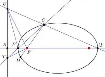

Here's a formal proof for the latter, based on the focus-directrix description (which is equivalent to the two-focus description) and the methods of Euclidean geometry in the plane. The key is to relate the ellipse to its auxillary circle, which is the circle whose diameter is the major axis of the ellipse. Given an ellipse with semimajor axis $a$ and semiminor axis $b$, we show that the perpendicular distance from the major axis to a point on the ellipse is $\frac{b}{a}$ times the distance from the major axis to the corresponding point on the circle.
Let $F$ be the focus of the ellipse. Let $l$ be its directrix, and let $P$ and $Q$ be its vertices. Let $C$ be an arbitrary point on the ellipse. Let $T$ and $U$ be the points where $\overleftrightarrow{CP}$ and $\overleftrightarrow{CQ}$ intersect $l$. Then $\frac{PF}{CF} = \frac{PT}{CT}$. This can be seen as follows. Let $A$ be the point where the axis of the ellipse intersects $l$, and let $B$ be the the foot of the perpendicular from $C$ to $l$ (not shown). We know that $\frac{PF}{PA} = \varepsilon = \frac{CF}{CB}$, where $\varepsilon$ is the eccentricity. On the other hand, $\triangle PAT \sim \triangle CBT$, so $\frac{PA}{CB} = \frac{PT}{CT}$. Putting these together yields the desired ratio.
$\hspace{3 cm}$enter image description here
It follows that $\overrightarrow{FT}$ bisects $\angle PFD$, where $D$ is the other endpoint of the chord from $C$ through $F$. (This is proved using the version of Euclid Proposition VI.3 for exterior angles, applied to $\triangle CFP$.) By a similar argument, $\frac{QF}{CF} = \frac{QU}{CU}$, so $\overrightarrow{FU}$ bisects $\angle PFC$. It follows that $\angle TFU$ is right. Therefore $AF$ is the geometric mean of $AT$ and $AU$, i.e., $AF^2 = AT \cdot AU$.

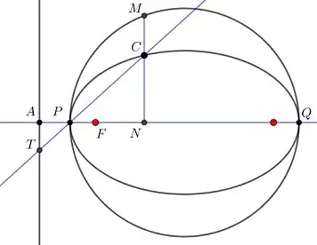

Now let $N$ be the foot of the perpendicular from $C$ to the major axis. Then $\triangle PNC \sim \triangle PAT$, so $\frac{CN}{PN} = \frac{AT}{AP}$. Similarly, $\frac{CN}{QN} = \frac{AU}{AQ}$. So \begin{equation} \frac{CN^2}{PN \cdot QN} = \frac{AF^2}{AP \cdot AQ} \end{equation} which is a fixed ratio, independent of $C$. If $C$ is on the minor axis, then this is seen to be $\frac{b^2}{a^2}$, so this must be the value in general.
Let $M$ be the point on the auxillary circle so that $C$ is between $E$ and $N$. Then the $\triangle PMQ$ is a right triangle, since it is inscribed in a semicircle, so $MN$ is the geometric mean of $PN$ and $QN$. It follows that $PN \cdot QN = MN^2$, hence $\frac{CN^2}{MN^2} = \frac{b^2}{a^2}$. So the ratio of $CN$ to $MN$ is $\frac{b}{a}$.
This proves that the ellipse can be obtained from the auxillary circle through vertical compression by the factor $\frac{b}{a}$. It follows then by a simple argument that the ellipse can also be obtained from the circle whose diameter is the minor axis through horizontal stretching by the factor $\frac{a}{b}$.
Translated into coordinates, where we consider the origin to be at the center of the ellipse, the $x$-axis along the major axis, and the $y$-axis along the minor axis, this yields the equation \begin{equation} \frac{x^2}{a^2} + \frac{y^2}{b^2} = 1 \end{equation} The fact that the area of the ellipse is $\pi ab$ is another consequence of this proof.
