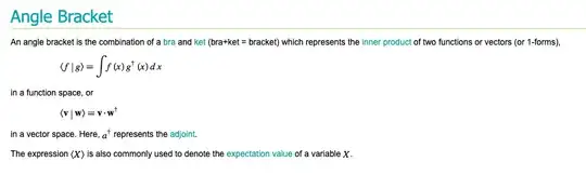

A clear and concise definition I found in Wolfram MathWorld which states a below, Angle Bracket
Its history is discussed by Professor Brailsford in Computerphile youtube channel here.
Another question was asked here which is more in the context of statistics and can be helpful to understand.
