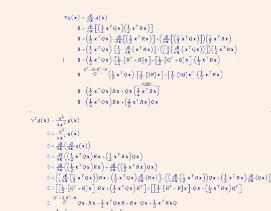

but while I notice (2nd element of the last row at the hessian calculation Ive got the term $2R\boldsymbol{x}\cdot Q\boldsymbol{x}$ which is column vector times another column vector and that's obviously a mistake.on my calculations product rule of gradient but I don't sure if It's a valid rule at matrix calculus. So, how can I calculate the gradient and the hessian of $g\left(\boldsymbol{x}\right)$?

  • and, in the 2'nd term , why did you change the order of $\alpha,\beta$? here what i did: link it became matrix plus scalar and that's is incorrect. – Omer Ben Apr 28 '20 at 15:15

  • $\alpha,\beta$ are scalar but $\frac{\partial\alpha}{\partial\boldsymbol{x}},\frac{\partial\beta}{\partial\boldsymbol{x}}$ are vectors , and I don't think you can just change their order.here what I did and encounter the same issue again: [link] (https://ibb.co/KXjY8Bs) – Omer Ben Apr 29 '20 at 15:44
  • thanks for all the support! just to be sure, here what I did : https://ibb.co/F7gYMyq originally I used product rule at (1) and got a dimensional error. but,at (2) I used product rule with commutative property I got the right answer.(without a dimensional error) I think I've got a mistake while using the product rule. what am I missing? – Omer Ben May 01 '20 at 10:14
