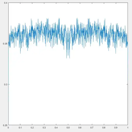

Attempting to plot this in MATLAB for $n=30$ and $1000$ equally spaced points, I get
with a geometric mean of roughly $0.3613$, which matches up reasonably for $n\in[25,30]$ as well as my integral results (see below). The supremum and infinum for these were found to be approximately
$$0.25\le\mu(x)\le0.3862$$
which suggests the upper bound may be given by $\frac{-1+\sqrt{17}}8$ from the fixed-point below.
