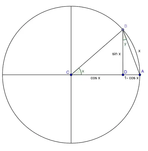

Here is a geometric squeeze:
Now we can show that:
$$ \frac{1 - \cos x}{x} \lt \sin \frac{x}{2}$$
We have $\displaystyle y = x/2$ ($\triangle ABC$ is isosceles and so $\angle CAB = \frac{\pi - x}{2}$) and hence in $\triangle BDA$, $\displaystyle \sin \frac{x}{2} = \frac{AD}{AB} \gt \frac{AD}{x}$, as $\displaystyle x$ is the length of the arc $\displaystyle AB$.
Aryabhata
