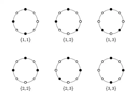

The expression $k+U-1\choose U$ counts the number of multisets of size $U$ drawn from $\{1,2,\dots,k\}$.
When $k=3$ and $U=2$, they are $\{1,1\}$, $\{1,2\}$, $\{1,3\}$, $\{2,2\}$, $\{2,3\}$, and $\{3,3\}$. These correspond to inserting the two unlabelled objects $U$ together with various separators. For example, $\{1,1\}$ corresponds to putting both $U$s with separator 1, while $\{1,2\}$ corresponds to putting one of the $U$s with separator 1 and the other one with separator 2. Each of these six multisets gives a "pattern" of 3 non-consecutive values in a circle of 8 unlabelled objects. Here are the six patterns, where a white dot is either a separator or one of the $U$s:
For each pattern, there are $n$ consistent ways to number the objects: put any value from 1 to $n$ at the top and add one (modulo $n$!) as you go around clockwise. The numbers in positions marked with $k$s (black dots in my picture) gives us a selection of $k$ non-consecutive values from $\{1,2,\dots,n\}$. As you run through all the patterns and all the numberings, each selection appears exactly $k$ times.
Therefore $\#\text{distinct selections}={n\over k}\times\#\text{patterns}.$
