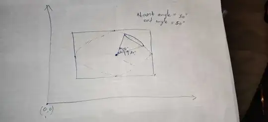

Given an arc that is a function of Rectangle that forms the total ellipse and then the start and sweep angle to finally get the arc , i need to test if a point P(x,y) lies inside the segment formed by this arc or not.
Basically here's some more details about it :
/// Draw an arc scaled to fit inside the given rectangle. It starts from
  /// startAngle radians around the oval up to startAngle + sweepAngle
  /// radians around the oval, with zero radians being the point on
  /// the right hand side of the oval that crosses the horizontal line
  /// that intersects the center of the rectangle and with positive
  /// angles going clockwise around the oval. If useCenter is true, the arc is
  /// closed back to the center, forming a circle sector. Otherwise, the arc is
  /// not closed, forming a circle segment.
  drawArc(Rect rect, double startAngle, double sweepAngle, bool useCenter)
Things that i want to know :
  • What's the equation of the arc that I get above
  • How to test if P(x,y) lies inside the segment formed by the arc
  • How to test if P(x,y) lies inside the sector formed by the arc
  • How to test if P(x,y) lies on the arc itself ( on the curved line )
  • How to test if P(x,y) lies on the arc segment or sector border (not inside but on the segment or sector boundary line)
  • How to test if P(x,y) lies on the arc segment or sector border given that the border is thick and has some width.
What data I have :
  • Full information about the rectangle ( its center , top , left , right , bottom)
  • the start angle (in radian say pi/2)
  • the end angle (in radian say pi)
Update :
  • The center (focus) of the arc is not assumed to be origin and could be anywhere.
  • The start and end angle are the actual angles and not part of some parametric equation. The angle could be anything and not just multiples of pi or pi/2 or anything like that.
  • Is a "start angle" or "end angle" the $\theta$ input of the parametric equations $x = a\cos\theta,$ $y = b\sin\theta,$ or is it the actual angle from the origin to the start or end of the arc? If the angle is a multiple of $\frac\pi2$ this makes no difference, but every other angle will give two different arcs depending on how you answer that question. – David K Apr 12 '20 at 19:45
  • For "the equation" of the arc, do you want a set of parametric equations or a set of equations and inequalities using just $x$ and $y$, like the equation $x^2+y^2=1$ for the unit circle? – David K Apr 13 '20 at 02:34
  • Suggest you add a picture that clarifies to you are seeking and its relevance to the rectangle. Usually the tests are straightforward. – Moti Apr 13 '20 at 05:13
  • I have updated my question. @DavidK – Natesh bhat Apr 13 '20 at 07:37

In the example in the question, the selected arc is inside a $30$ degree angle between lines from the center of the ellipse and is less than half of the entire ellipse. But if the arc goes counterclockwise from a start angle of $20$ degrees to an end angle of $220$ degrees, for example, the arc is more than half of the ellipse; the remaining part of the ellipse that is not part of the arc is smaller.
