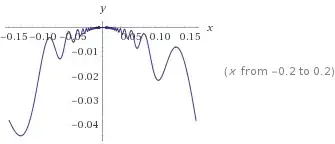

Consider the function:
$f(x) = x^2(\sin(1/x)-1.5)$ for $x \neq 0$ and $f(0) = 0.$
This is what the graph looks like (from WolframAlpha)
graph of <span class=$f(x) = x^2(\sin(1/x)-1.5)$ ">
$$$$ Then:
$f(x) < 0 $ for all $ x \neq 0$ because $ x^2 > 0 \ \forall x \neq 0 $ and $\sin(1/x)-1.5 < 0 \ \forall x \neq 0$. Hence the origin is a local (in fact, global) maximum.
Using the same method as the main answer to this question, we see that $f’(0) = 0.$
Furthermore, for $x \neq 0,\ f’(x) = 2x(\sin(1/x) - 1.5) - \cos(1/x),\ $ which is defined for all values $x \neq 0.$
Therefore $f’(x)$ is differentiable for all x in some interval containing the maximum (the origin). (In fact, we see that $f(x)$ is differentiable for all x).
However, we just found what the derivative of $f(x)$ is for $x \neq 0$: $f’(x) = 2x(\sin(1/x) - 1.5) - \cos(1/x)$, which, as $x {\to} 0,\ $ tends to $-\cos(1/x)$, and so oscillates between approximately -1 and 1 (as $x {\to} 0$).
If you want to know where my idea for this came from, I am somewhat familiar with the graph of $g(x) = x^2\sin(1/x)\ $ for $ x \neq 0 $ and $f(0) = 0.$
I considered “pushing the points” (other than the origin) downwards to just below $y=0$. I noted that $x^2\sin(1/x)$ just touches the graph of $ y=x^2$ at various points (as $x {\to} 0$), so I first considered $x^2\sin(1/x) - x^2,\ $ which, by the way, is the same as $x^2(\sin(1/x) - 1),\ $ and this would have been sufficient if the question didn’t require strict maximum. So for a strict maximum, I tried 1.5 instead of 1 and voila!.

    TL;DR: This function is a counterexample. It has a local (even global) maximum at $x=0$ but there is no interval $(-a, 0)$ on which $f'(x)>0,$ and no interval $(0,b)$ on which $f'(x)<0.$ – md2perpe Apr 11 '20 at 22:29
