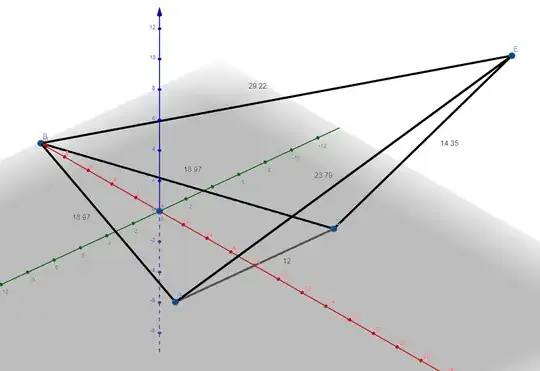

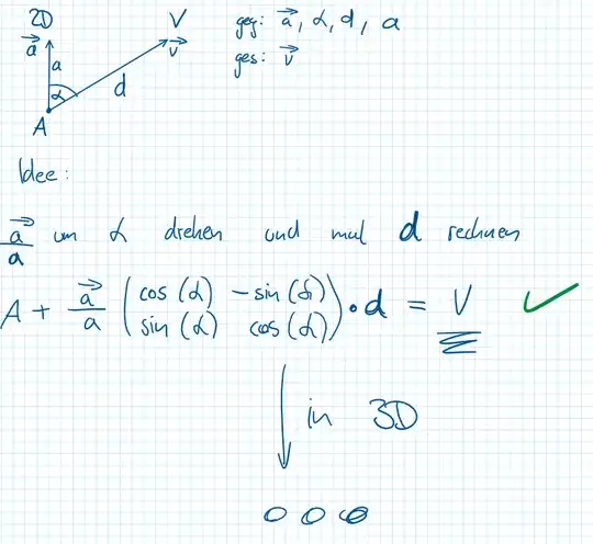

I need the coordinates of E and have the coordinates of A, B, C and the distance to them from E. It should be possible, in 2D I got it like this with a rotation matrix. But in 3D the angles of the edges are not parallel to axis so I cant really use the same principle can I ?

Thanks to @amd and @Tavish !
The problem is often not to find a solution but to ask the right question. Indeed I was really just searching for the intersection of 3 spheres and wikipedia had the answer. https://en.wikipedia.org/wiki/True_range_multilateration#Three_Cartesian_dimensions,_three_measured_slant_ranges
