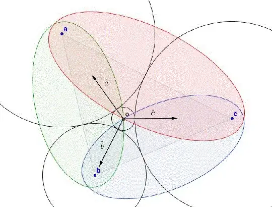

The condition $d_a + d_b < r_a + r_b$ is equivalent to $|s−a|+|s−b|<|x−a|+|x−b|$. i.e. $s$ is inside an ellipse with foci $\{a,b\}$ which passes through x. The existence of $s$ is equivalent to the interior of the 3 ellipses with foci $\{a,b\}, \{b,c\},\{c,a\}$ which crosses at $x$ has non-empty intersection.
To attack the problem, let us shift the origin to $x$. Let $\hat{a}, \hat{b}, \hat{c}$ be unit vectors pointing towards the three centers $a, b, c$. It is clear $x = \vec{0}$ is lying inside the interior of the convex hull formed by $a, b, c$. This implies existence of 3 positive numbers $\lambda_a, \lambda_b, \lambda_c$ such that:
$$\lambda_a (r+r_a) \hat{a} + \lambda_b (r+r_b) \hat{b} + \lambda_c (r+r_c) \hat{c} = \vec{0}$$
One consequence of this is the angles among $\hat{a}, \hat{b}, \hat{c}$ are all strictly smaller than $\pi$. Rotate the coordinate axis such that $\hat{c}$ is pointing in the $x$-direction. Flipping with respect to $x$-axis if necessary, let $\alpha \in (0,\pi)$ and $\beta \in (\pi,2\pi)$ such that $\hat{a} = (\cos \alpha, \sin \alpha)$ and $\hat{b} = (\cos \beta, \sin \beta)$. The arrangement is roughly as shown below:
Consider the ellipse with foci $\{a,c\}$ which crosses $x = \vec{0}$. Elementary geometry tell us its inward normal vector at $\vec{0}$ is in the direction of $\hat{a} + \hat{c}$. This in turn implies the interior of the ellipse lies inside the half plane defined by $\vec{s} \cdot ( \hat{a} + \hat{c} ) > 0$. Express everything in polar coordinates $\vec{s} = (\rho \cos \theta, \rho \sin \theta)$. The half plane containing the ellipse corresponds to: $$\theta \in \Theta_{ac} = (\frac{\alpha+3\pi}{2},2\pi) \cup [0,\frac{\alpha+\pi}{2}) $$
Similarly, the interior of the ellipse with focii $\{b,c\}$ lies inside the half plane: $$\theta \in \Theta_{bc} = (\frac{\beta+\pi}{2},2\pi)\cup [0, \frac{\beta-\pi}{2})$$
and the interior of the ellipse with foci $\{a,b\}$ lies inside the half plane: $$ \theta \in \Theta_{ab} = ( \frac{\alpha+\beta-\pi}{2}, \frac{\alpha+\beta+\pi}{2} )$$
The intersection of the admissible angles for the first two cases is:
$$\Theta_{ac} \cap \Theta_{bc} = (\frac{\alpha+3\pi}{2},2\pi)\cup[0,\frac{\beta-\pi}{2})$$
Notice $$\frac{\beta-\pi}{2} < \frac{\alpha + \beta - \pi}{2} \;\text{ and }\;\frac{\alpha+3\pi}{2} > \frac{\alpha+\beta+\pi}{2} \implies \Theta_{ac} \cap \Theta_{bc} \cap \Theta_{ab} = \emptyset$$
We can conclude the intersection of the three ellipses is empty.
