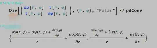

I know that his calculation results in Mathematica are as follows:
But I don't know how to get the above results manually. Can you help me solve this problem or provide relevant references ?
