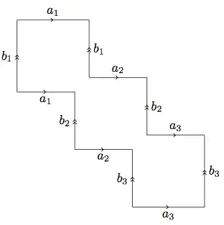

You should be able to convince yourself that the connected sum operation (cut a disc out of the two spaces and glue the resulting circles together) on tori is the same as cutting a corner off the squares and sticking them together, like this (for $T^2 \# T^2 \# T^2$):
Admittedly, it's a little harder to imagine actually folding this up to get a 3-fold torus, but with sufficiently stretchy material you can do it. If we have an $n$-fold torus (meaning the connected sum of $n$ tori $T^2$), we end up with $4n$ edges, identified in pairs. (This is typically drawn as a regular $4n$-gon, rather than the shape I've given here, but that makes it even harder to see how the quotient works!)
I also hope you know about cellular homology! We've drawn one 0-cell $v$ (all the vertices get identified after you fold up the $4n$-gon), $2n$ 1-cells ($a_1, \dotsc, a_n$ and $b_1, \dotsc, b_n$), and a single 2-cell $F$. The boundary map $\delta_1$ takes any of the 1-cells to $v - v = 0$. The boundary map $\delta_2$ takes $F$ to the sum $a_1 - b_1 + a_2 - b_3 + \dotsb + a_n - b_n - a_n + b_n - \dotsb - a_1 + b_1 = 0$. (You can see in the picture that the boundary of the 2-cell traverses each edge once forwards, and once backwards, so that they cancel out.) If the boundary maps are all 0, then homology is the same as the chain complex, and we have $H_2 = \mathbb{Z}$, $H_1 = \mathbb{Z}^{2n}$, and $H_0 = \mathbb{Z}$ (or replace $\mathbb{Z}$ with the coefficient ring of your choice.)
