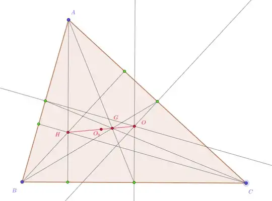

Let $\Delta ABC$ be a triangle with centroid $G$, then for any point $P$ we have the relation $$ \underbrace{PA^2 + PB^2 + PC^2}_{\sum PA^2} - 3PG^2 = GA^2 + GB^2 + GC^2 \ . $$ We write this relation for $O$ and $O_9$, thus getting $$ \sum O_9A^2-3O_9G^2 = \sum OA^2-3OG^2 = 3R^2-3OG^2\ . $$ Now note that the points $H,G,O,O_9$ are placed on the Euler line as follows: Euler line Explicitly $O_9$ is the mid point of the segment $OH$, (since the projection of $O_9$ on each side is the mid point of the projected segment, which is a chord in the Euler circle), $G$ is placed in the proportion $GH:GO=2:1$ (same side projection argument), so $O_9G=\frac 13 O_9O=\frac 13 O_9H$. This gives $$ 3OG^2 - 3O_9G^2 = 3\left(\frac 23\right)^2O_9H^2 -3\left(\frac 13\right)^2O_9H^2 = 3\left(\frac 43-\frac 13\right)O_9H^2 = O_9H^2\ . $$ Putting all together, we get $\sum O_9A^2+O_9H^2=3R^2$.

Synthetic Proof: By Leibniz Theorem, we have: $$PA^2+PB^2+PC^2-3PG^2=GA^2+GB^2+GC^2.$$ If $P \equiv O$ (the circumcenter of $\Delta ABC$), then: $$OA^2+OB^2+OC^2- 3OG^2=GA^2+GB^2+GC^2.$$ $$\text{i.e.}\;GA^2+GB^2+GC^2 = 3R^2-3OG^2.$$ If $P \equiv O_9,$ then: $$O_9A^2+O_9B^2+O_9C^2-3O_9G^2=GA^2+GB^2+GC^2=3R^2-3OG^2.\;\;\;(1)$$ But the points $H,O_9,G$ & $O$ are collinear, in this order on the Euler line. $O_9$ is the midpoint of $OH,$ and $$\frac{HG}{GO}=2$$ $$\implies O_9G=\frac{1}{3}OO_9=\frac{1}{3}O_9H$$ $$\implies OG^2-O_9G^2=\frac{4}{9}O_9H^2-\frac{1}{9}O_9H^2=\frac{1}{3}O_9H^2\;\;\; (2)$$ From $(1)$ and $(2)$, the desired result follows.
