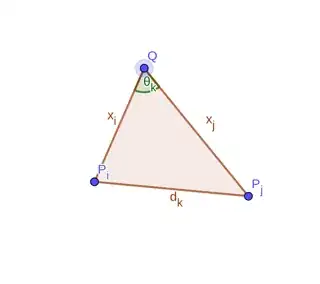

  • known angle $\angle P_i Q P_j$ is $\theta_k \in (0,\pi)$
  • known length of edge $P_i P_j$ is $d_k$
  • unknown length of edge $QP_k$ is $x_k$
The import of this is that the tetrahedral face $P_i Q P_j$ has angle $\theta_k$ opposite the triangle side of length $d_k$. Side lengths $x_i,x_j$ of this triangle are unknowns.
triangle face of tetrahedron
Figure 1: Typical face of tetrahedron with unknown edge lengths (click to enlarge)
As Li Li commented on your closely related Question, the Law of Cosines gives us a system of three quadratic equations for three unknowns $x_1,x_2,x_3$. For simplicity we write $c_k = \cos \theta_k$:
