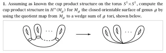

I'm working through the following exercise in hatcher. I would like to know how this map acts on the cohomology groups before computing the cup product. I denote the wedge sum of $g$ tori by $N$.
My main confusions are 1) in the first part how do we deduce that $c$ is mapped to the sum of $c_i$ by some local argument, and 2) how do we rigorously see that the generators are indeed mapped to where they should be.

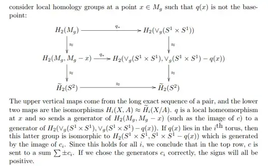

$H_2(M_g)$ has one generator which we denote $\sigma$. $H_2(N)$ has $g$ generators $\sigma_i$ one for each torus in the wedge. Intuitively $\sigma$ should be mapped to the sum of the $\sigma_i$ (maybe this should have alternating signs). I have found an argument here that I do not quite understand. Here is an extract of the argument enter image description here
I do not understand how the above argument deduces that $\sigma$ is mapped to the sum. A generator of $H^2(M_g,M_g-x)$ is sent to a generator of $H^2(N,N-q(x))$, but how does a sum come into play?

The argument you pasted has a significant error: the map $H_2(\vee_g T) \to H_2(\vee_g T, \vee_g T - q(x))$ is not an isomorphism if $g > 1$, it is the projection map $\mathbb{Z}^g \to \mathbb{Z}$ onto the factor corresponding to the torus containing $q(x)$ (you can still see this from the long exact sequence of the pair).
Since $q_*(c) \in H_2(\vee_g T)$, we know it is equal to $\sum_{i=1}^g a_i c_i$ for some coefficients $a_i \in \mathbb{Z}$. For a fixed $i$, choose an $x \in M_g$ such that $q(x)$ is not the basepoint and is contained in the $i$-th copy of $T$. Then from the true parts of the argument you pasted, the class $q_*(c)$ maps to the same element in the relative homology group as $c_i$ (up to sign, but we can chose generators so the sign is always $+$), and since the vertical map is projection onto the $i$-th coordinate that means that the coefficient of $c_i$ in $q_*(c)$ is $1$. Since this holds for each $i$, $q_*(c) = \sum c_i$.
