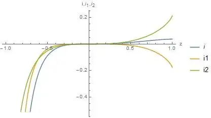

Here is a plot of the integrals as a function of $z$
