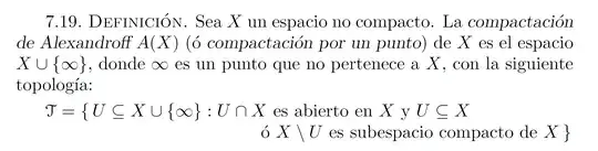

Let be $(X,\mathcal{T})$ a topological space -generally not compact- and let be $\infty\notin X$: so we say that the topology $$ \mathcal{T}^\infty=\mathcal{T}\cup\{U: X\setminus U\text{ is compact in $X$}\} $$ on $X^\infty:=X\cup\{\infty\}$ is the Alexandroff compactification of the space $X$.
Here an image of my text
Well I ask how to prove that $\mathcal{T}^\infty$ is a topology on $X^\infty$.
Could someone help me, please?

  • Here an another user give the same definition I given: anyway as reference I say to you that in "General Topology" by John L. Kelly it is written that $X\setminus U$ must be closed and compact in $X$ and not only compact as in the previoius definition. – Antonio Maria Di Mauro Mar 17 '20 at 21:47
  • Look more closely at your link: it says that $\mathcal T^\infty$ is the set of subets $U\subseteq X^\infty$ such that $U\cap X\in\mathcal T$ (i.e. $U\cap X$ is open in $X$) and, if $\infty\in U$, $X\setminus U$ is compact. Therefore $X\setminus U=X\setminus(X\cap U)$ is closed in $X$. –  Mar 17 '20 at 21:52
  • Okay, It's right: so what can I argue? – Antonio Maria Di Mauro Mar 17 '20 at 21:55
  • @HennoBrandsma Okay, so how can one prove that my $\mathcal{T}^\infty$ is a topology? – Antonio Maria Di Mauro Mar 17 '20 at 22:16
  • Sorry, now I edited the question: specifically I put an image of the definition of my text. – Antonio Maria Di Mauro Mar 17 '20 at 22:27
  • I put it now: the only problem is that it is in Spanish. – Antonio Maria Di Mauro Mar 17 '20 at 22:32
  • @Gae.S. For this reason I worte $\mathcal{T}^\infty=\mathcal{T}\cup{U: X\setminus U$ is compact in $X}$ – Antonio Maria Di Mauro Mar 17 '20 at 22:38
  • Sorrry if the image is in Spanish: I am italian and therefore I study books in Spanish rather than English because Spanish is very similar to Italian. – Antonio Maria Di Mauro Mar 17 '20 at 22:40
  • You have to read the "brackets" differently: the 'y' is between $U \cap X$ open in $X$ and the "o" statement, see my answer. It's a bit ambiguously formulated as it is. They should write a complete logical formula: $(U \cap X \in \mathcal{T}) \land ((U \subseteq X) \lor (X \setminus U \text{ compact in } X))$. – Henno Brandsma Mar 18 '20 at 06:34
So let $$\mathcal{T}^* := \{U \subseteq X^*\mid U \cap X \in \mathcal{T} \land (\infty \in U \implies X \setminus U \mathrm{\ compact)}\}$$
instead (as in the linked question) which does say something different then you had before: An open neighbourhood of the new point $\infty$ is of the form $U \cup \{\infty\}$ such that $U \subseteq X$ is already open in $\mathcal{T}$ and $X\setminus U$ is compact (in $(X,\mathcal{T})$ of course).
This is also consistent with the Spanish: you have to read it as ($U \cap X$ open in $X$) and ( either $U \subseteq X$, so $\infty \notin U$ or ( $\infty \in U$ and) $X\setminus U$ is compact ). So for any $U$ we have $U \cap X$ is open in $X$ at least. (and this is important for being a compactification, see below). The formulation as I gave it above is more explicit. It shows there are two types of open sets: the old ones from $X$ and new ones of the form $U \cup \{\infty\}$ where $U$ is "old" open and moreover has compact complement in $X$, which is important to show the new space to be compact.
