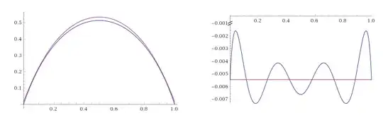

I don't know much about series such as $S(\theta)$, or whether there is any pattern to the values of $\sin((2m+1)\theta)$ as $m$ ranges over the nonnegative integers. What is certain though is that $0<\sin(\theta)<\theta$ and that $$|\sin((2m+1)\theta)|\leq1 \qquad\text{ for }\quad m\geq1,$$ because $0<\theta<\pi$. Now define the constants \begin{eqnarray*} A&:=&\operatorname{Re}\psi(\tfrac12+\tfrac12i)\approx-0.8681073626\ldots,\\ B&:=&\sum_{m\geq1}\frac{\operatorname{Re}\psi(\tfrac12+(m+\tfrac12)i)}{(2m+1)^3}\approx0.03247625\ldots, \end{eqnarray*} so that $$S(\theta) \leq A\sin(\theta) +\sum_{m\geq1}\frac{\operatorname{Re}\psi(\tfrac12+(m+\tfrac12)i)}{(2m+1)^3}|\sin((2m+1)\theta)| \leq A\sin(\theta)+B.$$ Putting everything together this yields $$T(x)\leq\frac{\pi^3}{16}\left(2\ln(2)+\gamma\right)x(1-x)+\frac12\left(A\sin(\pi x)+B\right).$$ This 'first order' bound can of course be refined by computing more initial terms of the series for $S(\theta)$, leaving a smaller remainder term $B$. For example, taking the first three terms yields the 'third order' bound $$T(x)\leq\frac{\pi^3}{16}\left(2\ln(2)+\gamma\right)x(1-x) +\frac12\left(A_0\sin(\pi x)+A_1\sin(3\pi x)+A_2\sin(5\pi x)+B_3\right),$$ where \begin{eqnarray*} A_0&=&\operatorname{Re}\psi(\tfrac12+\tfrac12i) &\approx&-0.8681073626\ldots,\\ A_1&=&\frac{1}{3^3}\operatorname{Re}\psi(\tfrac12+\tfrac32i) &\approx&\hphantom{-}0.0142581155\ldots,\\ A_2&=&\frac{1}{5^3}\operatorname{Re}\psi(\tfrac12+\tfrac52i) &\approx&\hphantom{-}0.0072753399\ldots,\\ B_3&=&\sum_{m\geq3}\frac{\operatorname{Re}\psi(\tfrac12+(m+\tfrac12)i)}{(2m+1)^3} &\approx&\hphantom{-}0.0109427956\ldots. \end{eqnarray*} Below are two plots comparing the upper bounds to the original function $T(x)$. The plot on the left shows $T(x)$ in blue, and the first order bound in purple; the third order bound is indistinguishable from $T(x)$ at this scale. The plot on the right shows the difference between the third order upper bound and $T(x)$. For comparison it also shows the constant term $-\tfrac12B_3$.
This shows that for the number of terms $A_m\sin((2m+1)\pi x)$ we have expanded, the constant term $\tfrac12B_3$ is quite tight (it seems we could decrease the constant term by about $0.0015$). It also shows that the difference is dominated by the next term $c\sin(7\pi x)$ for some constant $c$.

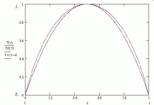

Mathcad calculated the following approximate graph of the function $T$. enter image description here
In this approximation we had a range both for $i$ and $j$ from $0$ to $100$. This approximation should be very precise because the series for $T(x)$ should converge very quickly, because for the range both for $i$ and $j$ from $0$ to $10$ we obtained an almost coinciding graph. I expect this approach can provide a rigorous computer aided bound for $T(x)$.
The graph looks symmetric, which suggest that $T(1-x)=T(x)$ for each $x\in [0,1]$. The graph suggest that $T(x)$ is a bit bigger than a quadratic function $4T\left(\tfrac12\right)x(1-x)$. The value $T\left(\tfrac12\right)$ calculated with the range both for $i$ and $j$ from $0$ to $10000$ is $0.51254399898721\dots$.
