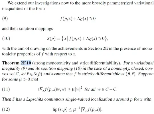

For constrained optimization problems
$$ \begin{array}{ll} \min\limits_{x \in \mathbb R^n} & f(p, x) \\ \text{s.t.} & x \in C \end{array} $$
where $p \in \mathbb R$ is a parameter, we can deduce, under suitable convexity conditions, existence and Lipschitzness (in $p$) of solution maps $x^*(p) \in \arg\min\limits_{x \in C} f(p, x)$, say, by applying Theorem 2F.10 from this Rockafellar's book. Here, I attached an excerpt from there:
Theorem 2F.10
Question: can we extend this result to the case when $C$ depends on $p$? Say, it is described by $g(p, x) \le 0$ with whatever properties required, like continuity in $p, x$, convexity in $x$ for each $p$.
The said book does not seem to contain a result in such a generic form.
One particular problem I see there is that the subgradients be pivoted to the static constraint. The argument collapses when the constraint changes
I'm almost sure that if the cost function is convex and the constraint doesn't change arbitrarily fast, the optimum must be continuous with a bounded rate of change

  • @LinAlg Nothing like that in there. Anyway, I'm almost sure that if the cost function is convex and the constraint doesn't change arbitrarily fast, the optimum must be continuous with a bounded rate of change – Rubi Shnol Mar 25 '20 at 08:59
  • Do you just want the existence of a continuous $x^*(p)$? Or do you also want it to be Lipschitz? – Theoretical Economist Mar 26 '20 at 20:43
  • @TheoreticalEconomist It has to be Lipschitz in $p$, I believe. – Rubi Shnol Mar 27 '20 at 12:52

  • I believe the reference is off, it should be the book "Implicit Functions and Solution Mappings" by Dontchev and Rockafellar https://sites.math.washington.edu/~rtr/papers/rtr208-ImplicitFns-DontRock.pdf – hrrrrrr5602 Apr 24 '23 at 17:06
