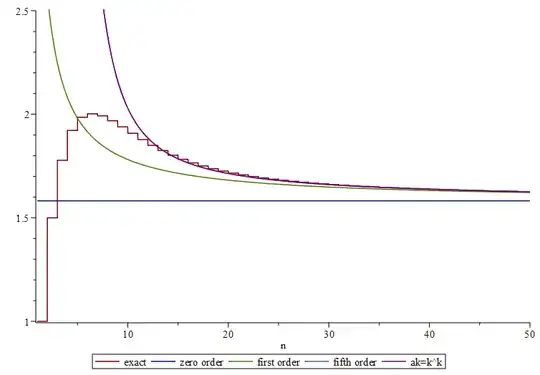

Increasing the order $K$ also shifts the range of validity to higher $n$, i.e. it is an asymptotic series. The zero, first and fifth order approximations are shown below. The fifth order is visually not distinguishable from the approximation where $a_k=k^k$ has been used for $k\geq 1$. comparison
