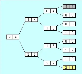

Let's take a simplified version of your problem so that we can see what needs to be clarified to obtain a pertinent answer.
Let's have two bins, containing $2$ and $4$ undistinct coins. We go and pick, casually, three coins.
"Usually", the above process of picking-up the coins is understood as that we choose one of the two bins, equi-probably, pick a coin from that and repeat independently from previous choice(s).
But it is clear that many other different picking processes can be devised That leads to the binary tree sketched below.
Balls_from_Bins_1
It is clear that the equi-probable, and possible, events of picking $3$ coins from the two bins are the $7$ events in the last column. Out of these, $6$ (the whites) will translate into picking from both bins.
It is true that the $6$ events can be collected under the unique partition of $3$ into two parts, i.e. $[2,1]$, and which corresponds, apart permutation, to the coins missing from the baskets.
But this "composed" event will not then be equi-probable with those discarded, and you are going to miss or mis-compute the term "out of N total ways".
