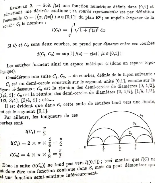

Consider a sequence of curves as follow:
$C_1$ is a semicircle drawn on the segment $[0,1]$, as in figure bellow; $C_2$ is the union of semicirocles of diameters $[0,1/2], [1/2,1]$; \, $C_3$ is the union of semicircles of diameters $[0,1/4],[1/4,1/2],[1/2,3/4],[3/4,1]$ etc....
Obviously, this sequences of curves tend to a limit, which is the segment $[0,1]$.
Moreover, the lengths of this curves are \begin{align*} l(C_1)& = \frac{\pi}{2} \\ l(C_2)& = 2\times \frac{\pi}{4} =\frac{\pi}{2}\\ l(C_3)& = 4\times \frac{\pi}{8} =\frac{\pi}{2}\\ \end{align*} So the sequence does not tend to $l([0,1])=1$.
How do you explain this bizarreness?
