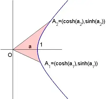

(see figure 1) Let us consider the right branch of equilateral hyperbola $(H)$ with equation $x^2-y^2=1$, playing the same rôle for this trigonometry as the unit circle for ordinary (circular...) trigonometry. In fact, the intrinsic meaning of $a$ is the area of the "triangle" $OA_1A_2$, with side $A_1A_2$ taken not as a straight line but as arc $A_1A_2$ on $(H)$.
The formula is plainly
$$\text{doubled area} \ \ 2a \ \ = \ \ a_2-a_1\tag{2}$$
The proof of (2) is easy ; indeed, (1) can be written :
$$\begin{pmatrix} \cosh(2a) & \sinh(2a)\\ \sinh(2a) & \cosh(2a) \end{pmatrix}\underbrace{\begin{pmatrix} \cosh(a_1)\\ \sinh(a_1)\end{pmatrix}}_{A_1}=\underbrace{\begin{pmatrix} \cosh(a_2)\\ \sinh(a_2) \end{pmatrix}}_{A_2}$$
which can be written, using the hyperbolic addition formulas :
$$\begin{pmatrix} \cosh(2a+a_1)\\ \sinh(2a+a_1)\end{pmatrix}=\begin{pmatrix} \cosh(a_2)\\ \sinh(a_2) \end{pmatrix}\tag{3}$$
Using the bijectivity of $\sinh$, one can deduce from (3) that $2a+a_1=a_2$ : we have thus proved (2).
Fig. 1 : Hyperbolic trigonometry with equilateral hyperbola (H).

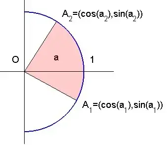

A comparison with usual trigonometry is enlightening. Take a look at figure 2. We could consider the association of the rotation sending $A_1$ to $A_2$ with the area of the angular sector, instead of the length of arc $A_1A_2$ (recall that it's the definition of the measure in radians of the "angle" $A_1OA_2$). This would be a good alternative to the measure in radian (with a measure $\pi$ instead of $2 \pi$ for the complete turn (think to formulas $\pi R^2$ and $2 \pi R$). It is a consequence of the formula $a=\tfrac12 \alpha R^2$ ; see here for the area of a circular sector and the measure $\alpha$ in radians of its angle. As a conclusion, we have the same formula (2) as for the hyperbolic case !
Fig. 2. : Circular trigonometry... with unit circle. The area of the circular sector is half the measure $(a_2-a_1)$ in radians of angle $A_1OA_2$.

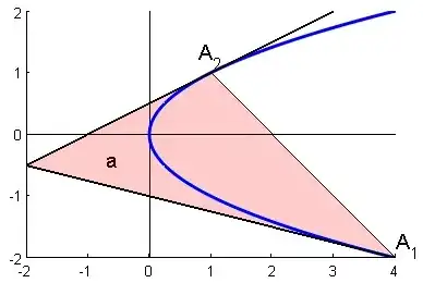

Now, let us consider another curve, the parabola. It is not well known that one can build a very sound geometry called 'equiaffine" or 'centroaffine' geometry (a reference) where the distance between the two points $A_1$ and $A_2$ is ... the cubic root of the area of triangle $A_1A_2B$ (fig. 3) obtained with point $B$ defined as the intersection of tangents to the parabola at $A_1$ and $A_2$. The fact that we need a cubic root should not be so surprising because we deal here in fact with "contact elements" (see legend of Fig. 3) which are characterized by 3 real numbers (two for the position and one for angle direction).
Fig. 3 : Equiaffine geometry : the equiaffine distance between two "contact elements" (contact element = a point and a direction) can be defined as the cubic root of the (pink) area $\sqrt[3]{a}$ where the featured parabola is the unique parabola with these "contact elements" (a connection here).
