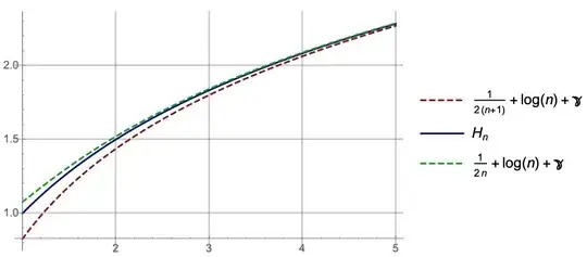

There are several inequalities giving upper and lower bounds on $H_n$, such as this one found on MathWorld (eqn 14):
$$\frac{1}{2(n+1)}<H_n-\ln n-\gamma<\frac{1}{2n}$$
where $\gamma$ is the Euler-Mascheroni constant:
Are there any equivalent inequalities for $H_n^{(k)}$? And how does one arrive at them?

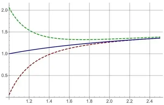

Heuristically, the following seems to hold, and offer nice tight bounds:
$$n^{-k} \left(-\frac{n}{k-1}+\gamma-\frac{k}{12 n}-\frac{1}{n^3}\right) +\zeta (k)<H_n^{(k)}<n^{-k} \left(-\frac{n}{k-1}+\gamma-\frac{k}{12 n}+\frac{1}{n^3}\right) +\zeta (k)$$
For example, this is a plot with $k=1.8$:
Is this inequality valid? And how do I prove it?
NOTE: This is a substantial revision of the original question, which was unclear - and since which, I have found the above potential bounds on my own. The bounty is for validation and proof.
