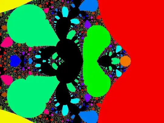

The Mandelbrot of the exponential map shows that zero is at the center of a period two region (the circular orange region). So all of the points near zero are also period two. So 0 and 1 make sense as solutions.
