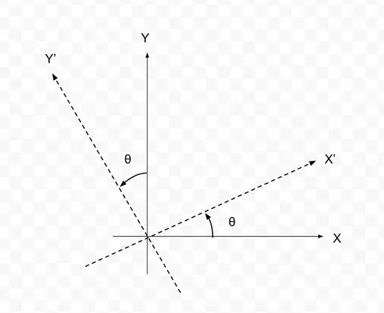

You might want to consider this as a possible way to work out the various relationships. Consider a 2D coordinate system that is rotated with respect to another coordinate system. Take the unprimed to be "canonical" and the primed to be the "new" coordinate system:enter image description here
Now, in terms of matrices we can write the following for the rotation matrix that transforms coordinates from unprimed to primed:
$$ A= \begin{bmatrix} \cos \theta & \sin \theta \\ - \sin \theta & \cos \theta \\ \end{bmatrix} $$
To see this in action, take the unit vector along the x-direction (in the unprimed canonical system) and see what the result is:
$$ A= \begin{bmatrix} \cos \theta & \sin \theta \\ - \sin \theta & \cos \theta \\ \end{bmatrix} \begin{bmatrix} 1 \\ 0 \\ \end{bmatrix} = \begin{bmatrix} \cos \theta \\ - \sin \theta \\ \end{bmatrix} $$
From the above, we see that the coordinates in the primed-system are $$ \begin{bmatrix} \cos \theta \\ - \sin \theta \\ \end{bmatrix} $$
If you compare to the figure, you see this is consistent in that the original x-vector projects onto the positive x-prime coordinate (reduced by a cosine factor) and also projects onto the negative y-prime coordinate.
I hope this helps.
