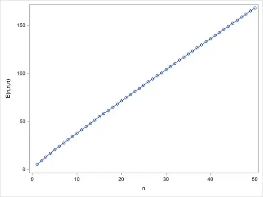

Let $E(r,g,b)$ be the expected number of draws to obtain at least $r$ red, $b$ blue, and $g$ green marbles. Then $E(0,0,0)=0$ and otherwise $$E(r,g,b)= 1+\frac{1}{3}\left[E(\max(r-1,0),g,b)+E(r,\max(g-1,0),b)+E(r,g,\max(b-1,0))\right].$$ Solving this recursion yields $E(25,25,25)\approx 87.9057937186312$, in close agreement with @InterstellarProbe's second estimate. A plot of $E(n,n,n)$ for $n=1$ to $50$ is nearly linear: enter image description here
The Wikipedia article for the Coupon collector's problem gives a reference to Newman and Shepp (1960) for this generalization, and the exact value is $$E(25,25,25)=3 \int_{0}^\infty \left[1-\left(1-e^{-t}\sum_{k=0}^{25-1} \frac{t^k}{k!}\right)^3\right] \mathrm{d}t.$$
