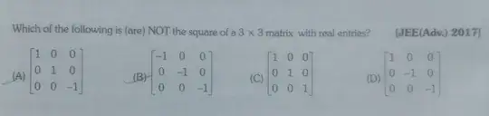

The question is from JEE Advanced(2017), where it asks to identify matrices which are the square of a matrix with real entries:
I first found out the determinant of all the matrices. Options (A & B) both have negative determinant value and hence can't be expressed as square of a matrix with real entries. For explanation let any of the two be called as $A$ . Given they are square of another matrix(let $B$) so $B^2=A$ . Taking the determinant on both sides, I get $|B|^2=|A|$ and since $|A|$ is negative, I get $|B|^2<0$. So $B$ can't have all real entries. Option C is $I$ whose square is $I$ or vice versa. I am having trouble with option D . Since it's determinant is also positive and I can't find a simple matrix which when squared gives that option. I have talked to my teacher . He said there is a method to find square root of a matrix but that's far beyond our level. I am a High school student studying in grade 12. So please, if possible, give a simplified hint/answer.

Regarding only the $yz$ plane, $D$ rotates by 180°. What if you rotate by 90° twice?
