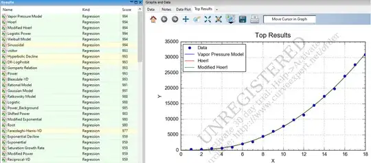

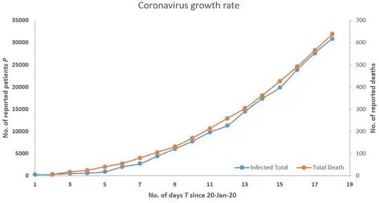

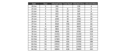

The objective is the model the growth rate of the Coronavirus using avaibale data. As opposed to the standard epidemiology models such as SIR and SEIR, I tried to model a direct relation between the number of infected or deaths as a function of time so as to capture the early days trends. I collected the latest data on the coronavirus from Johns Hopkins University as shown and fitted different curves to this data to model the relationship between the number of confirmed patients $P$ who are/were infected as function of time $T$ taking 20-Jan-20 as day 1.
The curve fitting software I used has well known models form different branches of science as well as we could build our own custom models which I did as shown in the image below. The score against the name of a model gives how well a model fits this data. The higher the score, the better the fit and the maximum possible score is 1000. Although we have data only for 18 days (as of 7-Feb 2 AM GMT) one model always kept appearing at top as the best fit and this was the vapor pressure model. After checking for various boundary conditions, I rejected many of models but I could not find any immediately reason to reject the vapor pressure model. Similarly when I modeled the number of reported deaths against time, the vapor pressure model once again gave the best fit which for which I could not find any obvious reasons to reject.
So I did some research on the vapor pressure model.

    I am curious how well the empirical curve matches the initial segments of the curves of infected individuals in SIR and especially SIS models. Visually they look pretty similar. Could it be that the Antoine curve happens to be a good fit for those in the early stages of an epidemic? – Conifold Feb 07 '20 at 06:37
16
What you have here is a severe case of overfitting. You only have 18 data points and you test a large variety of different models each of which has several free parameters. One of these models with optimized parameters will fit you data very well, regardless of what the data looks like.
The number of death is growing and there are various medical models telling you what a typical infectious disease spread looks like. Trying to do better than this with the little data available does not lead to useful new insights. In spite of the excellent fit for the data observed so far, there is no reason to believe your model is better at predicting the future than any of the models public health researchers usually use for these kind of situations.
quarague
  • 6,505
    Well the 18 data points is something that we have to live with since we can at best get only one new data point per day. On the other hand waiting for more data is not a option in this situation because of the need to forecast the impact of the virus in my daily job (tourism). So despite its limitations, we have to work with whatever data we have. So I had to take inspiration from Gauss who accurately predicted the position of Ceres using data points on only three days and ended up inventing least square regression :-) – Nilotpal Sinha Feb 07 '20 at 10:24
    @NilotpalKantiSinha I know you can't easily get more data. But the conclusion should be that you can test only very few very simple models and anything beyond that just doesn't give reliable predictions. Of course you can say that your model fits the existing data very well. But with this few data points you can't make any good reliable predictions into the future, no matter what. So using the knowledge from previous epidemics is much better than overfitting the little data we have on teh Coronavirus. – quarague Feb 07 '20 at 10:36
    Ob. xkcd: https://xkcd.com/882/ – Eric Towers Feb 07 '20 at 14:50
    @EricTowers I was actually thinking about that one https://www.xkcd.com/2048/ – quarague Feb 07 '20 at 14:52

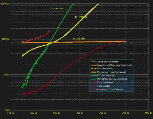

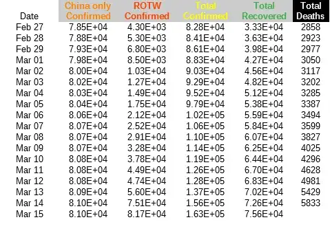

I chose the polynomial with the best-case R² or non-negative growth rate in the case of Mainland China 0.3%/6days vs 100% growth/6ays for ROTW.
This is based on John Hopkins Univ. (JHU) global data. using Curve fit with LibreOffice Version: 6.4.0.3 (x64) enter image description here
I realize predicting beyond 2 wks is about as accurate as predicting bad weather.
