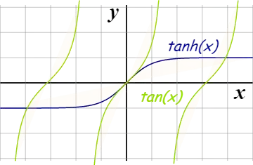

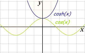

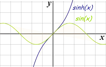

The followings are the graphical representation between geometric and hyperbolic functions (especially for $\sin x,~~\cos x,~~\tan x,~~\sinh x,~~\cosh x,~~\tanh x$ ).
  • Relation between Hyperbolic function and Trigonometric function:
Hyperbolic sine: $~\sinh x=-i\sin(ix)~$
Hyperbolic cosine: $~\cosh x=\cos(ix)~$
Hyperbolic tangent: $~\tanh x=-i\tan(ix)~$
Hyperbolic cotangent: $~\coth x=i\cot(ix)~$
Hyperbolic secant: $~\operatorname {sech} x=\sec(ix)~$
Hyperbolic cosecant: $~\operatorname {csch} x=i\csc(ix)~$
