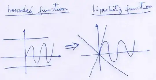

I'm trying to understand intuitively the notion of Lipschitz function.
I can't understand why bounded function doesn't imply Lipschitz function.
I need a counterexample or an intuitive idea to clarify my notion of Lipschitz function.
I need help

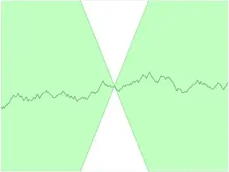

It means that your function does not explode at some point - made mathematically rigorous.
This idea can also be shown geometrically like so (picture from wikipedia):
The Lipschitz condition (or Lipschitz continuity) ensures that your function always remains entirely outside the white cone, so it cannot e.g. become infinitely steep at one point.

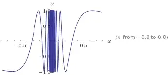

Concerning your picture: Think of the function $sin(1/x)$ (source W|A):
You see that it is becoming infinitely steep at the origin (and would therefore run into the white cone!) but it is still bounded.
