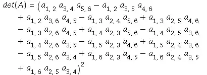

The result can be generalized as follows -and that is known since 1849 (Jacobi and Cayley)-.
$\textbf{Proposition}$. Let $A\in M_n(R)$ where $R$ is a commutative ring and $A$ is skew-symmetric.
Then $\det(A)$ is the square of an element of $R$.
For a proof, cf.
https://en.wikipedia.org/wiki/Pfaffian
https://core.ac.uk/download/pdf/82800447.pdf
For example, when $n=6$
